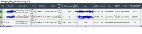

in WLAN Service, the default authenticated role does not take effect , any one noticed the same?

the default role for authenticated is not taking effect .
only when i respond with filter -id the roles will get applied, but if filter-id is not in the response the authenticated and non-authenticated users gets the same role (quarantine) , although this should change to Allow_All role after authentication.

802.1x , the radius server responds with vlan id , but no filter-id , once authenticated and put in correct vlan users should be allowed all.
Doug
Seems to be working fine in my lab. I would need to understand your setup better. I would suggest contacting the GTAC.
