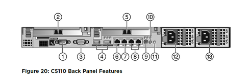

Let's start with the most basic question - which of the below ports have you connected ?
esa1 = #2 = the fibre port
Is the esa1 enabled on the controller GUI > Controller > Network > L2 Ports > checkmark for esa1 is set and it's not in a LAG
-Ron
-Ron
