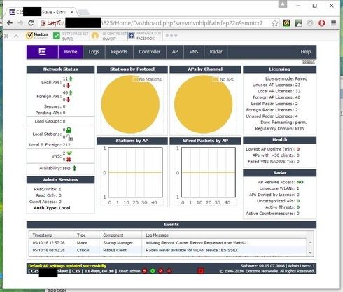

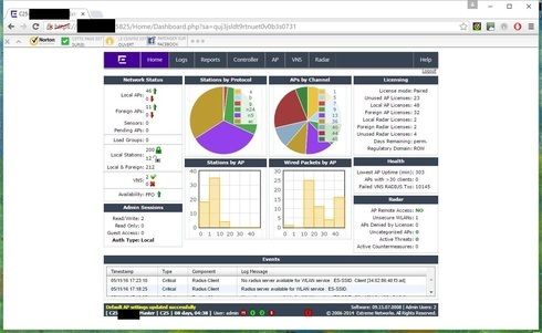

When using two C25 with HA, I see 46 APs up on the Master with correct pie, but for the other one with 11 APs up ... I see Nothing
Is it a refresh problem ... (after trying to disconnect, connect and rebooting the C25 : same problem)
02ed7013cf34448f9d722981c778a609_RackMultipart20160511-70654-184dnpp-WiFi_007_inline.jpg
02ed7013cf34448f9d722981c778a609_RackMultipart20160511-53620-1kilset-WiFi_006_inline.jpg

I'm pretty sure that the 11APs have the active tunnel to controller#1.
You'd release the tunnel on controller#1 in > AP > Bulk Configuration > Access Approval
- select foreign in the pull down menu on the right
- click the release button below
The APs should set the tunnel to controller#2 to active and you should see the correct statistics.
