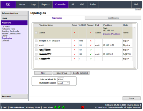

please see attached...
‎07-17-2018 03:33 PM
Could you please post a screenshot of > controller > network > topologies
for some reason no discovery at all, DHCP cannot be enabled in the Controller, following the online help the menu is different and does not allow any DHCP config.
