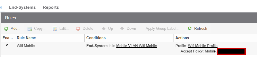

My rule with just an end-system group :

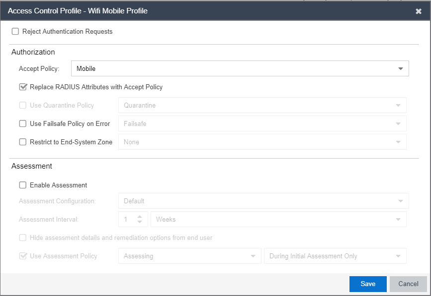

My profile :

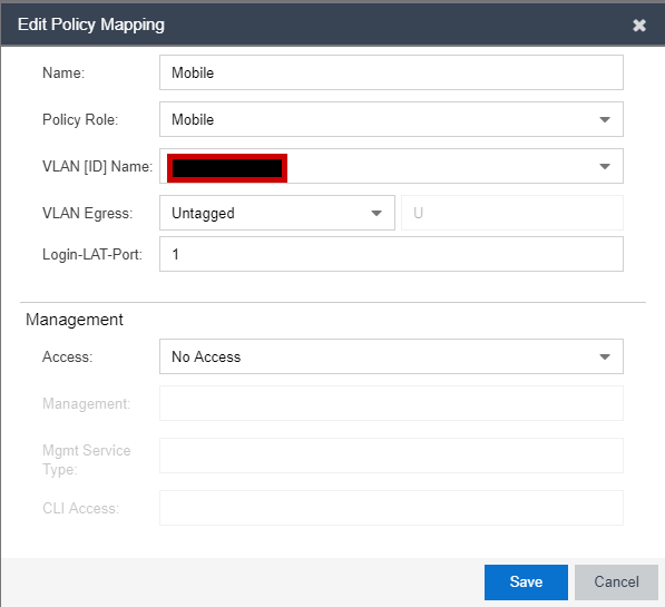

My policy :

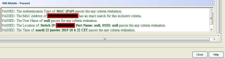

The result of my configuration eval tool :

  • the rule that you've created
  • "Profile" and "Accept Policy" = the pop up window if you click on it (see red arrows bellow)

@Tyler Marcotte : I see my mobile in NAC's end-systems and when I do a Configuration evaluation tool, I see that my device match my rule.

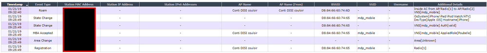

  • enable the station events > Controller > Logs > System Log Level > Report station events on controller
  • connect again with the client
  • check the logs > Logs > EWC > Station Events
  • filter on the client MAC
  • post a screenshot of the result
