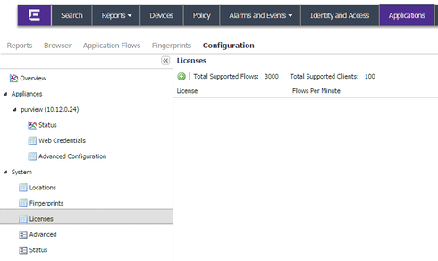

Mike,
The customer has a VM, the VM and Netsight has on the same server. On my lab, the purview show the information, but on the customer not. If you see the image attach, you will see the information of my lab and customer
the collector not show any data

Luis, is the customer platform running on a VM? It would need to be responsible likely for decoding the tagged packet and forwarding to the PurviewVM.
a tcpdump, if seen with packets like above, should indicate your getting netflow packets to the purview appliance. The purview appliance must then be sending data back to the Netsight appliance to display the data. As mentioned above, sometimes the Netsight appliance is used for looking at applications flow, it is the default , and needs to be changed to the Purview appliance.
Hi..i havê the same situation. On my lab purview is populate because the port is not tagged. On customer the port is tagged and purview dont populate . any idea
