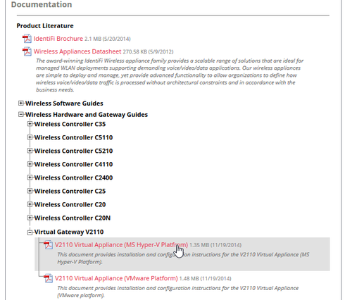

Drew_C
Valued Contributor III
I believe the document Ron is referring to can be found on this page: https://extranet.extremenetworks.com/downloads/Pages/WirelessControllers.aspx
Look on the documentation page under Wireless Hardware and Gateway Guides -> Virtual Gateway V2110

Regarding the screenshot - you either configure a bridge@EWC OR bridge@AP but not both.
As I've mentioned it comes down to the network design which method to use.
I'd recommend to read the manual "V2110 Virtual Appliance Installation Guide - MS Hyper-V Platform" page#13, there are the instructions to support tagged VLANs in Hyper-V which you need for bridge@EWC toplogies.
If you use bridge@AP the controller can't be the DHCP server - you'd need an external one.
