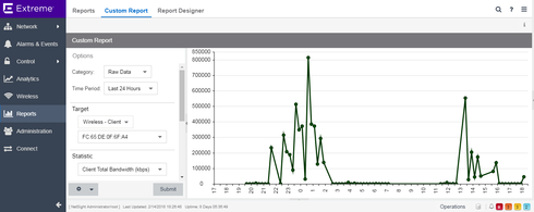

You'd run a report for a certain client....
or get even deeper information with Analytics (needs another VM running)....

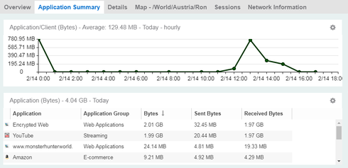

Is there a report that shows how many Mbps each client is getting, like a download speed, or how much bandwidth each clients is using? I did download and install the NetSight tool, but still working on setting it up to view some better reports.
