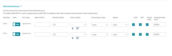

I´m searching for a solution on AP4000 to connect Hanshow USB Dongle for ESL (C09978) into a VLAN.

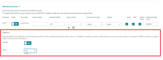

The setting "USBNET" for USB Port seems to be missing on the AP4000, which is possible on AP305C.
How can we configure the USB interface, when only the ETH interfaces are shown in the template or device
