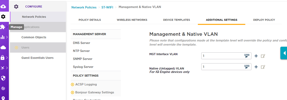

The management VLAN is for management traffic between Extreme Networks devices and ExtremeCloud IQ and control traffic among network members. The VLAN that you specify must match the VLAN ID that is already configured as part of the trunk port on the connecting switch to allow traffic on that VLAN. Management and control traffic includes CAPWAP, GRE, NTP, SCP, SSH, SNMP, Telnet, TFTP, and Extreme Networks Cooperative Control messages. The default VLAN for mgt0 is 1.
The native (untagged) VLAN is the VLAN assigned to frames that do not have any 802.1Q VLAN tags in their headers. By default, Extreme Networks devices also use VLAN 1 as the native VLAN.

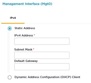

Thanks for the reply. Yes, we did exactly as you say, filling in the Static IP details after checking the Static Address radio button.

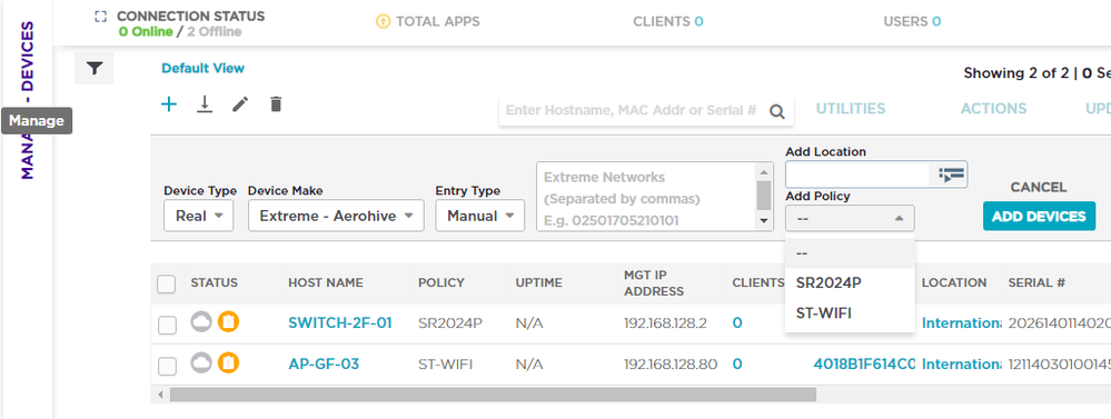

Recall at the very beginning, we first Quick Add the AP device (via Manage => Devices), and assign the AP with the Policy (the Add Policy dropdown box).
Once the AP was added to the device list and when we see the AP is connected in the Status column icons, we click on the AP Host Name link and get the device config panel. At that moment the AP took a DHCP Address 192.168.128.80.
We then pressed Configure button => Device Configuration, get the input fields as you mentioned, check the Static Address radio button, and fill in the IP Address, Subnet Mask and Default Gateway fields as you say.
However, after we pressed Update to update the config, the result is what I showed in the screen dump, the static address that we wanted to assign fall into the Automatically Generate Interface IP Settings fields, and the DHCP address 192.168.128.80 still stick with the AP.
Another point that I don’t understand is about the Management VLAN field. I cannot get the AP connect while I add the device, if I setup this field in the device template under the Network Policy. If I setup the device template in the Network Policy, go to additional settings, and fill in 50 in the MGT Interface VLAN field, the AP won’t connect when I applied the Policy while adding the device.
I have to set the MGT Interface VLAN field as 1, then apply the Policy while adding the device.
After that the AP added to the device list and connected. At that point if I connect a laptop to one of the SSID broadcast by the AP, the laptop cannot get the DHCP address for the VLAN that associate with the SSID.
I have to then click on the individual AP device link in the device list, then press Configure => Device Configuration, and change the Management VLAN field as 50 (or I believe any VLAN ID that I didn’t defined in the router port), and update the config again. After that the laptop that connect a SSID from the AP can get the DHCP address appropriately.

Hello Jacky,
You should be able to assign a static IP when you click on the Static Address radio button:
Here’s a link that will aid you on this: https://extremeportal.force.com/ExtrArticleDetail?an=000057294
