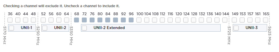

on our manager (extremcloud IQ, hivemanagerNG on last version) How can I enable the UNII-2 frequency ?
Because when I create a 5Ghz radio profile, only 36 to 48 and 149 to 165 are allowed.
All of my Ap’s is with the LU country.

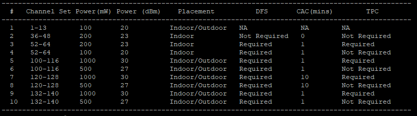

Per LU regulations these are the available channels:
I hope this helps,
Christoph S.
I hope this helps,
Christoph S.

As channels 68 and 96 are available within the EU, this might not be set to the country regulatory settings within the AP.
However you would need to check that Channels 68 and 96 are allowed to be utilised within the country as these will differ between EU countries
If they are allowed would suggest raising a GTAC case to ascertain why these channels are not part of the LU regulatory settings.
lje

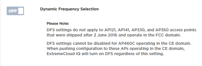

oh, ok with DFS enable, it’s better. But the 68 and 96 is always disabled.

Within the Radio Profile you have specified have you turned on DFS
