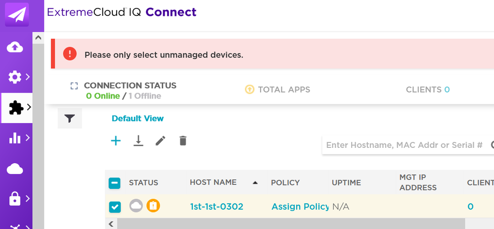

06-23-2021 04:50 PM
I called Extreme Network support number and got it sorted out.
Basically I need to reset it to factory default when I remove it from Hive Manager, then I can add it to XIQ connect. Before I chose “keep the existing configuration” which was wrong.
06-23-2021 02:10 PM
Thank you Christopher. I registered with XIQ Connect free version.
My temporary entilement key with Hive Manager will expire in 30 days. I'd like to use XIQ Connect free version to manage it going forward.
So I removed my AP230 from the Hive Manager. Then I went back to ExtremeClound IQ Connect, and manually onboarded this device. However, when I check the CONNECTION STATUS, it's showing 0 online and 1 offline. The AP230 is for sure up and running because I'm using it right now. I followed this instruction, (https://extremeportal.force.com/ExtrArticleDetail?an=000057264), selected "Manage" -> "Action" -> "Change Management Status" -> "Manage Devices", I got a message of "successfully added to new". But in the "CONNECTION STATUS", it's still showing "0 online / 1 offline". If I try to do it again, it shows me "Please only select unmanaged devices." Please see below screenshot and the output of “show capwap client”. I logged out and logged back in the next day but I still got the same thing. If I log into Hive Manager, I can see that my AP is still trying to connect it but got denied because I deleted it from the inventory. How can I move my AP from Hive Manager to XIQ Connect? Please help.
