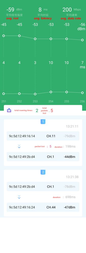

I walk with android running two tools(termux and wifi魔盒), walk from one ap zone to another ap zone, and rear back. Here are the results:

  • wifi魔盒(Developed by a chinese corp, so I translate the chinese to english)
the result indicate that there is one packet lost when roaming, the latency is huge big: 698ms
wifi魔盒 roaming result
it seems there are 5 packets lost when roaming
question:
  1. what utilitis how do you guys use to evaluated roaming?
  2. how to tune the roaming speed up?
