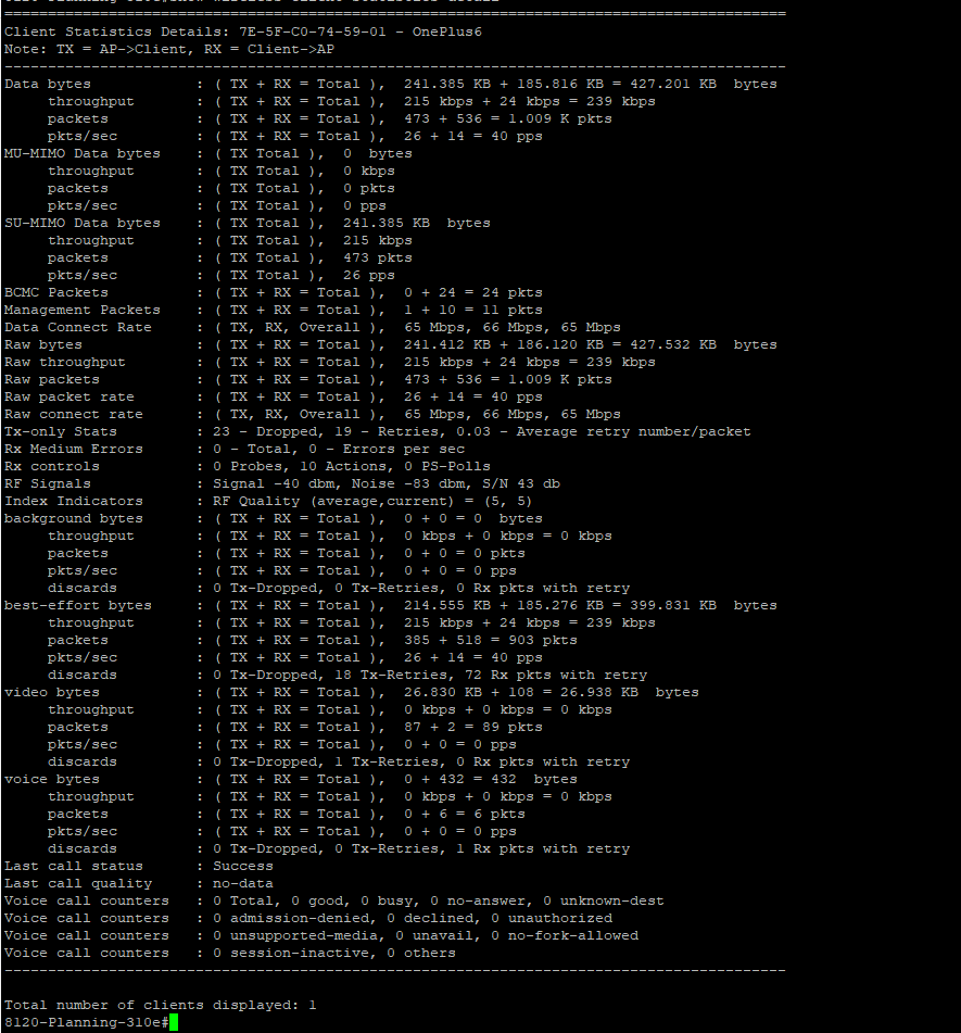

I’m having issues with the 2.4ghz network. At first when connecting to an SSID it says connected, no internet. Shortly after that it starts working, but extremely slow. Speed tests have it at .016mbps download and 1mbps upload. Using a wifi analyzer I notice the only channel it stays on is 11. I have a smart rf policy that has channel 1,6, and 11 for the 2.4ghz network but it looks like it’s stuck on 11.
I need some help getting the 2.4ghz network working. If I enable the same SSID on the same AP connected to the same port but enable it on the 5ghz radio it works great. Upload and download speeds are both about 200mbps.

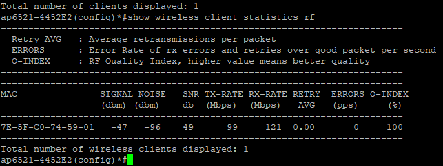

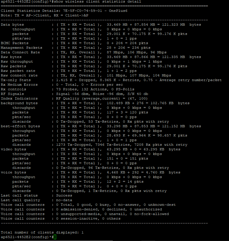

@Chris Kelly I plugged the old 6521 in, setup the ssid the same way. I don’t believe smart rf is being used on it, and it’s on channel 1 which seems to be used by a lot of wireless networks around here, I’m not sure how to force it onto channel 11 with the CLI. The throughput and speed works decently with 50 download and 50 upload. Even that would be acceptable on the new system.
Here’s those last 2 commands run on the 6521:
Command 1:
Command 2:
ckelly
Everything looks very good on those stats.
At this point, I’d still want to see how the 6521 compares.

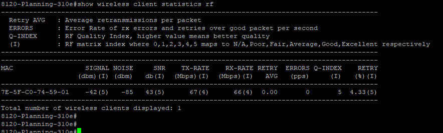

Sethg103
Command 1:
Command 2:

Okay, so those antennas are dual-band, so no issue there.
The energy graph doesn’t indicate a problem with non-wifi interference...and it does appear that smart-rf selecting channel 11 makes sense based on the output.
