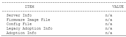

Are the AP310i APs getting a DHCP lease or are they statically assigned an address?
On one of the AP310i APs, run the command:
# show ip dhcp-vendor-options
If the output looks like this, then the AP is not getting the Option 191 information:
If it’s working, then for the “AP Adoption Info” section, you would see the information you entered on the DHCP server (test this on a AP7532 that you think is working to see how it SHOULD look).
Also, on the DHCP server, make sure that you did NOT enter a Vendor Class ID that only specifies the AP7532. If you did, then only the 7532 APs would get the DHCP Option.
Refer to page 5 on this Best practices Guide.
I’ve also attached a section of a document that covers how to setup a MS DHCP server for Option 191 using Vendor Class information. This would help verify if you have setup the DHCP server as I mentioned.
