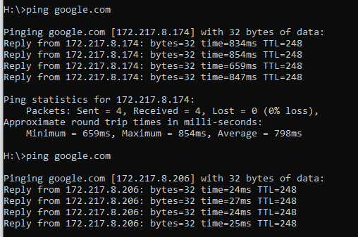

Sethg103
@Ovais Qayyum How do we tell if the controller is acting as a gateway? I’ve got a controller at building 1 building that’s adopting the building 2’s access points but when I try and test out an ssid at building 2 the ping is extremely bad so I was wondering if there was any troubleshooting methods on if the controller is getting building 2’s traffic when it should just go to building 2’s router and then the internet. Here’s a picture of a ping from an AP controlled by the nx5500 and our current virtual controller. They’re both set up the same way so I’m confused to why the ping is so high on the controller adopted AP.
Ovais_Qayyum
Please share the controller running-config here so we can take a look.
