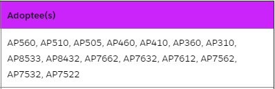

Christoph_S
Here are the WiNG 7 supported APs:
The above can be adopted by a WiNG 7 NX5500 controller.
Thank you,
Christoph S.
Sethg103
Can the outdoor AP-7562 be upgraded to wing 7? Or is there a similar outdoor model that would be compatible with the nx5500?
Christoph_S
You should be able to upgrade the AP7632 to wing 7
Thank you,
Chris
Christoph S.
