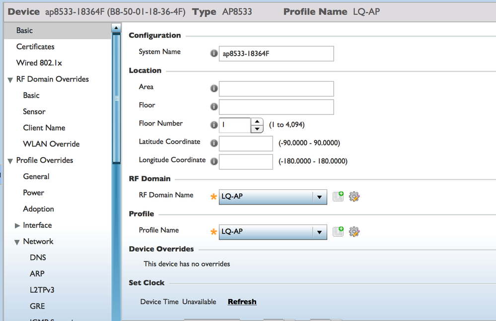

Hi everyone.
I am currently trialling the Extreme Wing software and trying to get some APs online..
I have plugged in AP8533 and it appears under Configuration > Devices as expected.. From here, I assign it to a Location and RF Domain ( as seen here ).

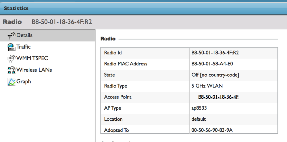

However, when I reboot the AP, under Dashboard > Devices.. the Radios are showing as Off because it has not been allocated to Location.. When I query further it seems the Location is Default which is different to what I set earlier in Device configuration ?

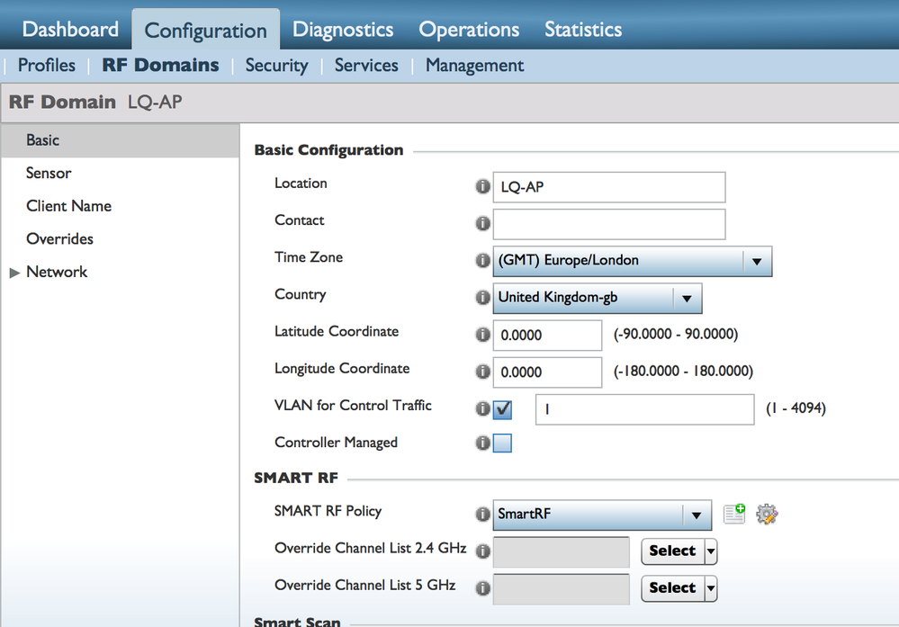

I have looked through all the RF-Domains and Profiles and all looks corect, so cannot see what I've missed which is cuasing it to point to Default Location ( instead of LQ-AP as defined above )

Hi Chris, thanks for your reply.. Apologies, i am still finding my way around the gui so probably sent the wrong screen shots..
Within the Device > Basic, the RF is already set to LQ-AP which is what I want it to be..
And as you rightly said , a country code is required within the RF-Domian for the Radios to become active.
As far as I can see this is correct too ?
The problem seems to be when the AP comes online and registers, it seem to dis-regard the settings above and go to Default profile ( where there are no country codes applied ) and therefore radios do not become active. Screen shot taken from Dashboard > Device...
Obviously, i can get around this by defining something in the Default Profile, however I would like to use my "LQ-AP" created one..
