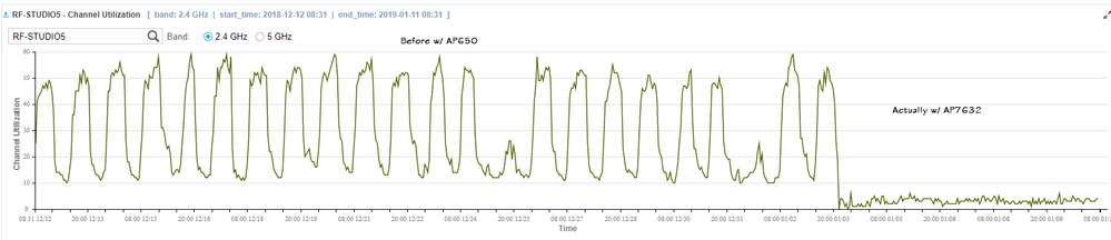

Hello community,
I changed my ap park on site from ap650 to ap7632. This correct?
Number of channel utilization on 2.4 Ghz decrease w/ new AP.
My WiNG Version is 5.9.1.5
Thanks!

Hello!
WiNG 5.9.3.1 solves this problem on NSight Graphs.

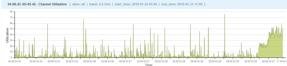

Hi Robert!
I setup 5 sites with ap7632 (version 5.9.1.5). Many issues (drop connections) observed here.
ap650/7532/7522 w/ 5.9.1.5 operated very stable on vx9000.
5.9.2.2 is best version for ap7632? I can post feedback here after update.
RobertZ
AP hardware acts differently so the graph maybe ok. Are you experiencing any client connectivity issues?
Ideally you should be on 5.9.2.2 and above, but until you phase all the AP650s your stuck.
