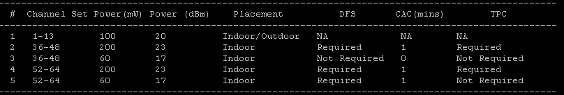

Hello community,
I need to set the R2 to work with 5Ghz on non-dfs only channels for VOIP, but our regulation is quiet difficult:

Christoph_S
Hello Aviv,
Looks like you can only use channels 36-48 in your case. Yes you can configure smart-RF to only use the non-DFS channels.
SSH into controller and run the following commands:
>en
#conf t
#smart-rf-policy policyname
#channel-list 5GHz 36,40,44,48
#com wr
#show context
Is this what you are looking for?

Thanks you for the replies,
The goal is to use all the channels 36-48 with 17DB as appears on regulation screenshot.
So I need to set in smart rf the maximum power level in case of Ap7532int ant:
17DB (max allowed for non-dfs) - 4DB (ap's antenna gain) = 13DB ?
So I have to set the maximum power level on 5Ghz 13DB to use only NON-DFS?
The problem is - the same channels 36-48 are DFS with 23 DB.
How can I know is the current channel and power settings currently in DFS or NON-DFS mode?
