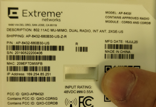

Here's a picture of the back of the AP (had to put my thumb there because my phone kept trying to read the QR code instead of taking a picture):
