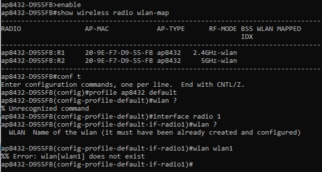

@Christoph S. Following that link I was able to get the country code set. Now there is a new error for the radios not being turned on:
I continued to follow that link to set the wlan, but it gives me an error for that too:

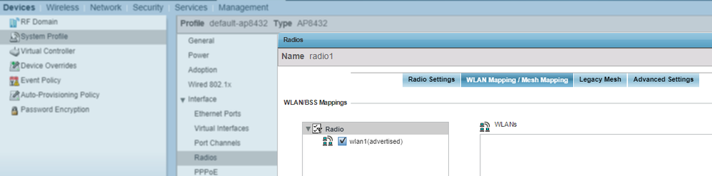

​e1255a66dba14ce1af9221d35b2b1478.pngBut the wlan[wlan1] does exist and is already set for that AP by the default:

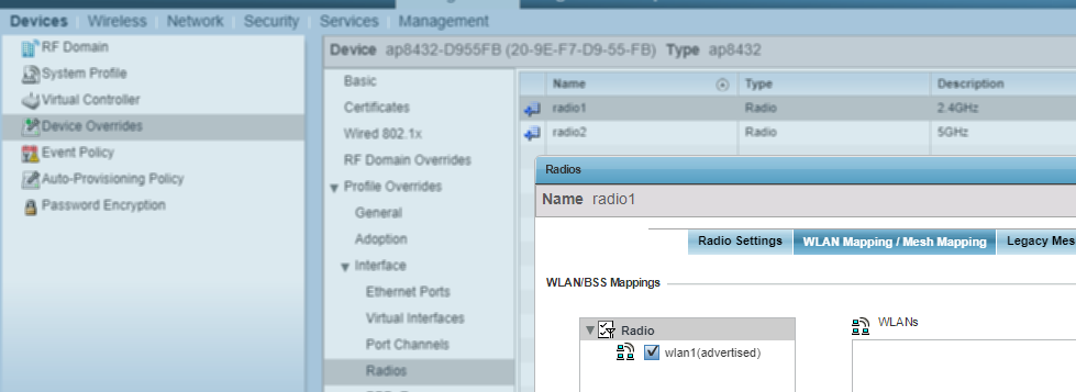

2dd550a92b864c78828fd79374a2e0d4.pngSo, I checked the AP overrides, and it is there too:
debb6789599f42159eae938d28ff9776.pngSo, now I'm stuck again with the radios being off.
