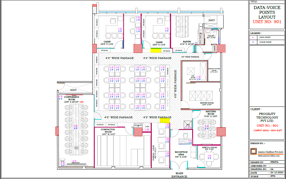

Does AP310i connected in line of site cause any slow speed or coverage issue due to interference?
In our HO we have VX9000 controller installed along with 2 310i Access points connected in line of site to each other. Users complaining slow speed issue also coverage is less.
Please refer attached floor plan along with access point placement marked in yellow.
Please let me know if the 2 access point in line of site causing any issue? How can I confirm what is the issue?
