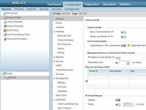

						HI all,
I am using AP 7532 & AP 7522E, Both firmware are 5.9.2. can i create vc redundancy for these both AP's? possible means guide me. now AP 7532 is a virtual Controller.

‎08-03-2018 04:13 PM
						As Chris Frazee mentioned, you might want to hold off on configuring the AP7522E as VC redundant, until SPR #3484 is resolved.
But to answer your question, the setting is at the bottom of the General page:

‎02-07-2019 10:25 AM
						Hi
is SPR #3484 is resolved yet does this apply to the AP7532, @ FW5.9.2.1
Is there a setup guide / best practice guide ?
‎02-07-2019 04:52 PM
						Fix for SPR #3484 is in WiNG v5.9.3.0 and higher.
‎02-07-2019 04:54 PM
						OK,
just waiting for our GTAC+ to be setup so I can get access to the FW for the AP's on support
Thanks
Thanks
