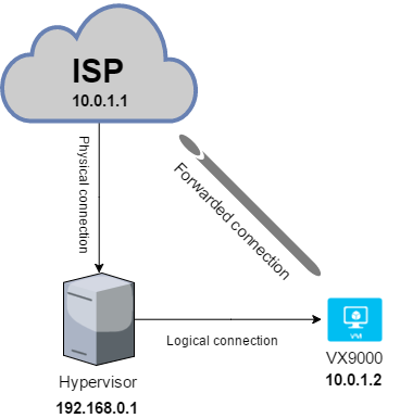

Also, I noticed in your diagram that VX9000 is in the same network segment as the ISP?
I am testing via a laptop by the way. VX9000 is installed on the same laptop as a virtual machine. The laptop, AP, and the ISP cable are inserted on one same PoE switch. this is my set up. Will this work?

HI Ronaldo,
If I understand correctly, below topology is what you wish to have, right?
fd1249176b3d407bb69f5c4472fbb389_RackMultipart20170426-125057-pzmnyz-newone_inline.png
If yes, this will be in control of hypervising server. You may use forwarding, VLAN tunneling or segmentation.
VX9000 will be only part of specific subnet in scope of hypervisor and will accept ISP or manually added IP address.
Every AP keen to adopt to this VX9000 will need to know its public IP.
Also port UDP 24576 has to be open on VX side for MINT (level2) adoption.
Regards,
Ondrej
