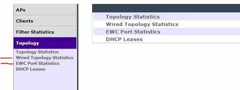

I think it's hard to find the root cause for the link loss. How long till the tunnel was up again ? Just from this one screenshot the first thing that I'd check is the ESA utilization as you use only one port of the controller. I'd also check the switch port counter and reset it to see any error counter increase over time.
‎07-06-2017 04:36 PM
Yes, that is the one port your controller is using now. As Ronald stated, you can get the information from the Topology/EWC Port Stats, or Wired Topology Stats.

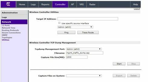

Also, you can take a tcpdump packet capture from the ESA port (eth0) from Controller/Network/Utilities page to get a feel for the network traffic traversing that port:
What is the Availability timeout set to (seconds)?
