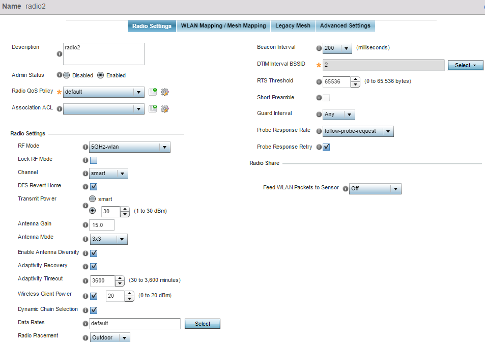

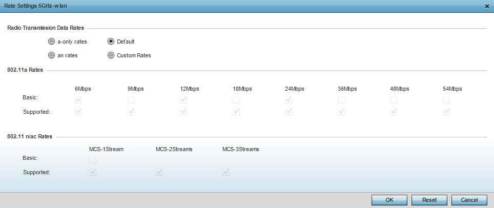

Hi ;
I am trying to solve Wing AP problems in an hotel for one year. We cant get any support especially in Turkey for Wing products.
We had so many problems about download speeds and intermittent disconnects. Some engineers came from Extreme HQ in Turkey and told that there are network issues, not about Wing. But when we run an Aruba AP in the same networks we hadnt seen any problem.
I tried to solve the issues by searching the support pages and community topics.
But one problem is really disturbing.

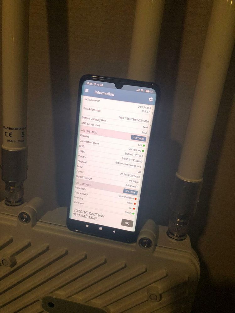

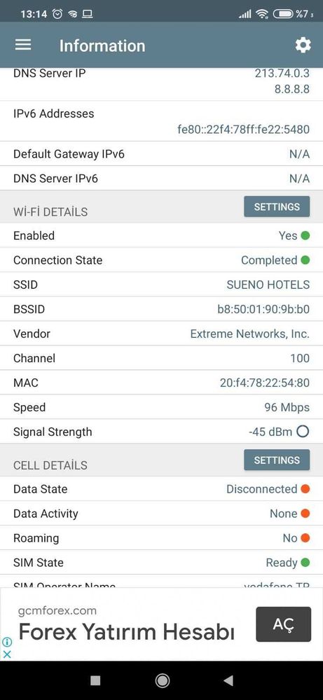

As you can see the pictures below for AP7562 and AP7532 radio2 i cant get maximum data rates. When i connect an Aruba 275 in the system same location, i can see maximum data rate 866 Mbps. With same phone when i connect to 75xx AP’s, despite being near the AP and see -45 dbm, i can only see maximum speed 96Mbps in channel 100.

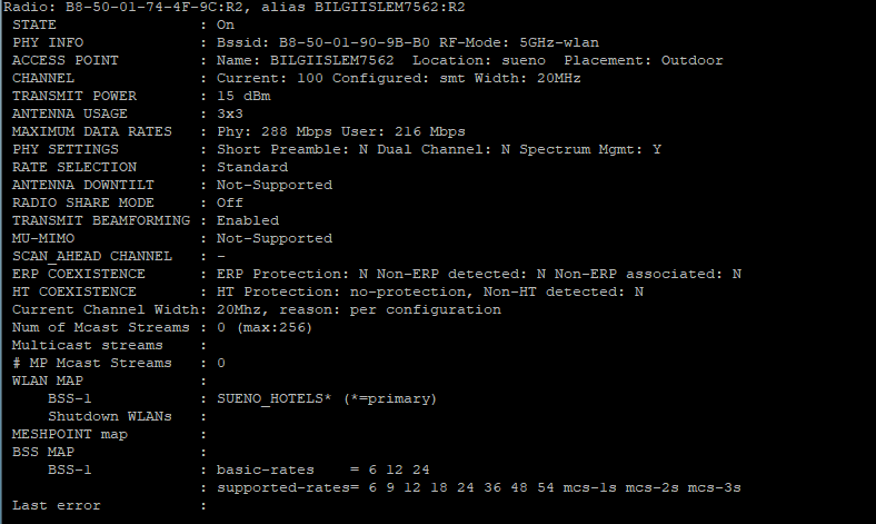

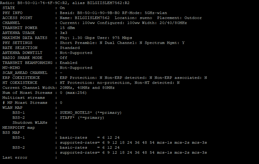

From “show wireless radio detail”. I can see AP is operating with 80Mhz and speed can be up to 1.3Ghz with 3 stream. Normally, Android only support 2 stream, so 866 is Max as you said.

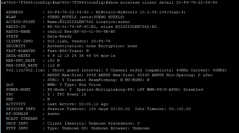

From “show wireless client detail”, AP understand that this client capability is only 802.11an, 1 stream, and 40Mhz channel width. To reach 866, it should be 802.11ac, 2 stream, 80Mhz.
This info is based on conversation between AP and client during association phase. I suspect something wrong during at that phase. *Probe request/response, association request/response, authentication request/response.
I think we need further investigation including wireless packet capture. You may open GTAC case with valid support entitlement. You will need to provide tech-support file, wireless packet capture. They will inform you what they need for investigation once you opened case.

Yes, the point is i know the capabilities of 7532 and 7562 but i cant see the maximum data rate as 866 Mbps. When i plug Aruba 315, same phone can give the maximum data rate 866 but in Extreme AP’s i cant see the AC data rates.
When you said me to change the operating channel, i made 100ww and the data rate increased only 150 mbps. (When dynamic channel it was only 96)

Please try below command and see what is the operating channel width.
#show wireless radio detail
 CHANNEL              : Current: N/A Configured: smt Width: 20M
Below command also gives you some idea what is client capability.
#show wireless client detail
Depends on country,  5Ghz require DFS. When radar is detected, WiNG narrow down operation channel width.
I tested with my AP7532. It can reach to 866Mbps
