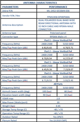

We are using combination of 7662 AP and outdoor ML-2452-SEC6M4-036 antenna. I understand that on AP there's one side for 5MHz connections and the other is for 2.4
I couldn't find anywhere information on how to connect antenna to the AP. There are 4 cables on the antenna, 2 with -45 markings and 2 with +45. Which one goes where? Or it doesn't matter?

Please find the characteristics below:
So all ports are dual-band, but you should use one +45 and one -45 for each band.
