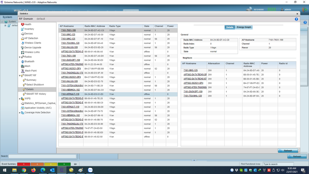

I use controller RFS4000 and 10 AP 7161 and 6 AP 7562. When I turn on Smart RF  it seems Wifi Network is worse.
Should I manually set transmit power for each AP?

As per the output, only few 5GHz radios are offline, most are ON and have DFS channel assigned to them. So, if you are not using them just disable them in the AP profile to keep things simple. Afterwards, please send following command outputs. Let’s take a look at some configuration and what the APs are seeing.
VX9000-Primary~# enable
VX9000-Primary~#show running-config rf-domain <rf-domain-name>
VX9000-Primary~#show running-config smart-rf-policy <policy name>
VX9000-Primary~#show wireless radio on <rf-domain-name>
VX9000-Primary~#show smart-rf channel-distribution on <rf-domain-name>
VX9000-Primary~#show smart-rf interfering-ap on <rf-domain-name>
VX9000-Primary~# show smart-rf radio neighbors on <rf-domain-name>
VX9000-Primary~# show smart-rf history on <rf-domain-name>

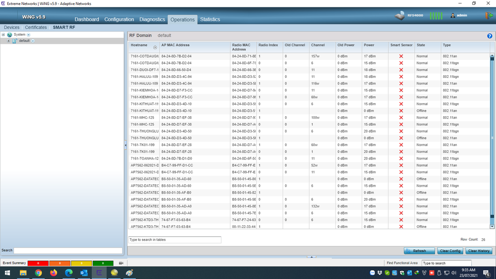

Thank you for your response, I would like to provide the following information:

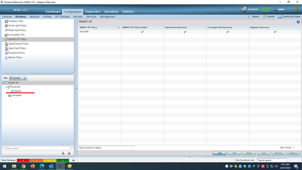

1 - Is Smart-RF applied to the RF-Domain you want to use it for? => YES
2- Is “Smart Monitoring” in Smart-RF settings enabled? => YES

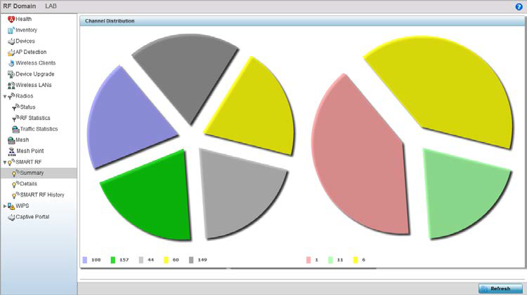

3- How does the channel distribution look like?

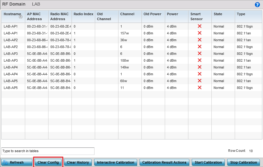

You should probably clear Smart-RF config once to let the APs converge on to the proper channels, go to Operations > rf-domain-name > SMART RF to clear Smart-RF config. It’s an intrusive change and would impact client connectivity for the period while APs perform OCS and Smart-RF assigns correct channels.

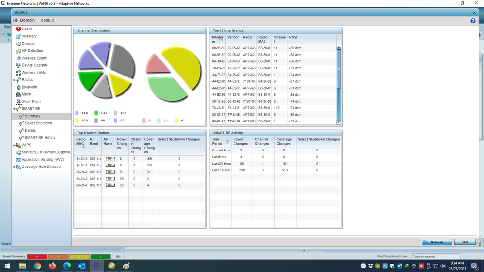

You can also share Smart-RF energy graph, Smart-RF history and Smart-RF interfering APs details, all of which are available under Statistics > rf-domain > SMART RF tab.
