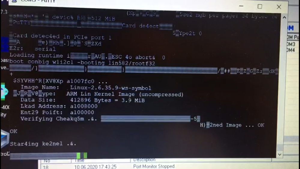

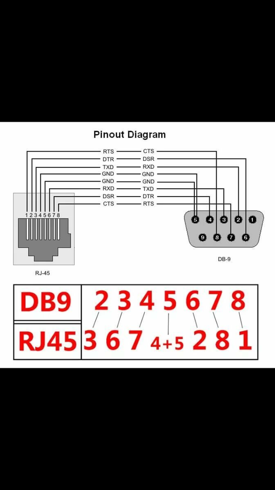

I am trying to connect to the controller (RFS-4010) and AP 7562 using a console cable. The cable was make independently, the scheme was found on the Internet (in the attachment). But I can't connect via the console port. In attach I insert one screen on my computer.
Please help me, maybe my scheme pinout console cable is wrong?
I use application Putty
serial port setting:
  1. Speed: 19200 or 115200 ( i tested Booth speed)
  2. Data: 8 bit
  3. Parity: none
  4. Stop: 1 bit
  5. Flow Control: None

Tell me, what is the error? As far as I can see, we have the same Pinout with you.
RobertZ
I think you have the pinout wrong it should be as below:
Pinout: RJ45 - DB9F
  • 1-8
  • 2-6
  • 3-2
  • 4,5-5
  • 6-3
  • 7-4
  • 8-7
