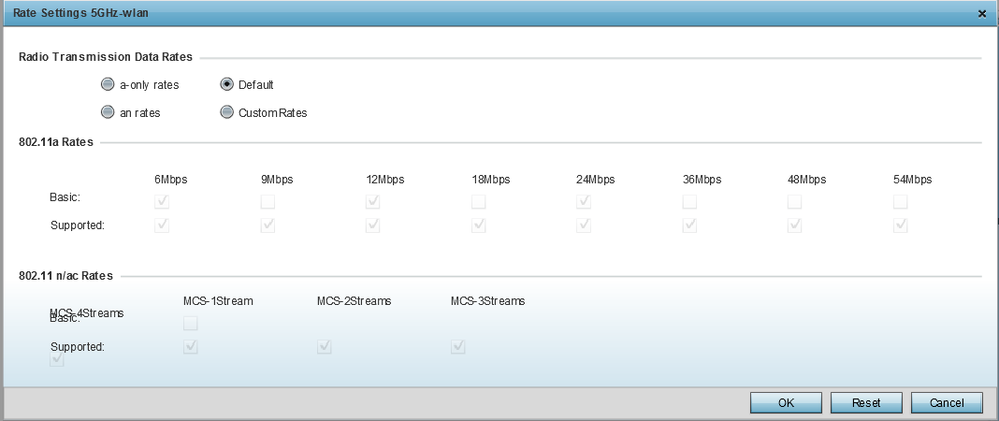

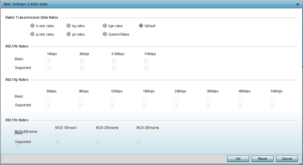

Hello,
What are the recommended data rates to set up on WING for best performance and quality?
enviroment: office
AP density: up to 15 AP per floor
client density: up to 10 clients per AP
client type: mostly PCs and Laptops with Win 7,8 an 10, couple of smart phones (iPhone, Android etc) and TVs.
At the moment I have default values:

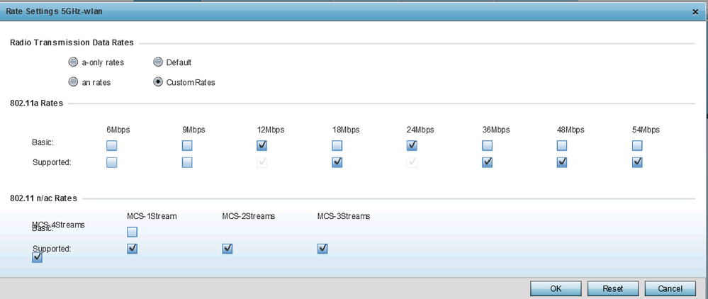

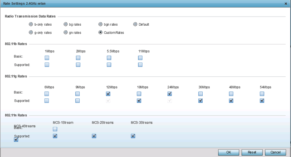

But maybe I should change to this:
