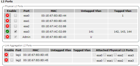

GTAC has always recommend that we disable the administrative L2 port on the controllers. So currently we just have one physical interface. Controller and AP's live on 141 and the rest are wlan segments. For reference:

We have 339 AP's bridged to a pair of 5210 controllers. Until recently we had one wireless vlan (/19) across three campuses with a few thousand clients and never had any congestion issues on the controller.
