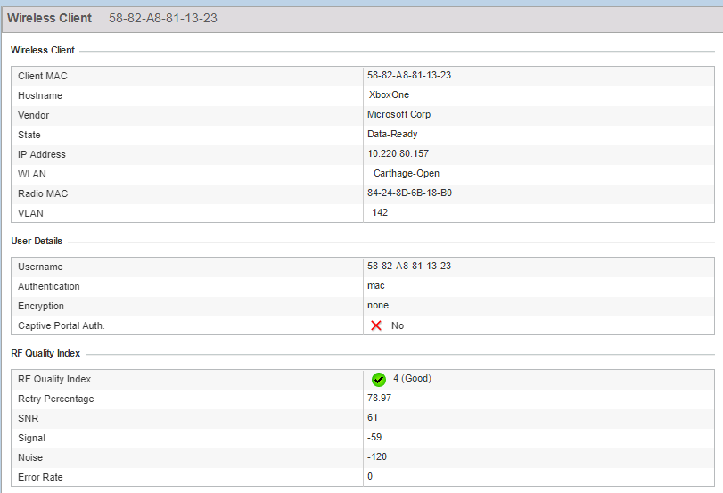

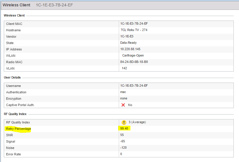

I'm writing from a College environment where we have just over 850 WiNG APs. We are currently running WiNG 5.9.5.0-007R. We are ~2 weeks into our semester and we have just recently started receiving many complaints about network speeds/reliability/etc...
While digging into this, I stumbled on some extremely high retry percentages (see two examples below):

Looking at these two examples though does help to start ruling out some potential causes though.
In both cases, you have extremely high SNR and RSSI, and a very low noise floor. Fantastic. These three things alone would normally dictate a very healthy environment that should allow for maximum data rates to be used.

In your examples, the Error rates are zero. This indicates to me that there are no issues with corrupted CRC values. If there were, the frames would be discarded and would be considered an error.
The SNR, RSSI, and noise levels seen on the AP are so good that you're not dealing with a 'distance' related issue (are there APs located in the same room as the devices??) At these levels, the devices shouldn't have any issues with even the highest BASIC rates being set.

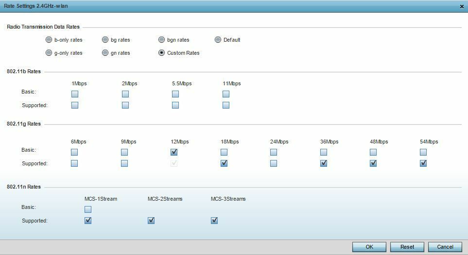

A few things I can respond with:
We have the following Radio Rates setup in our WLAN profiles:

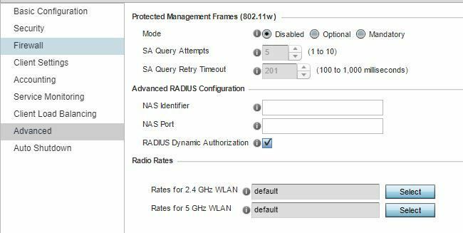

Because we were told it was better t do it in our AP profiles:
I'm under the assumption that my radio rates are setup to best practice. Can you confirm?

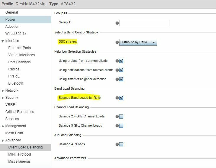

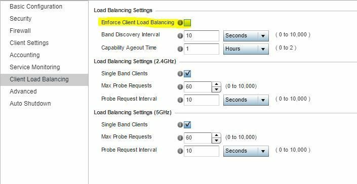

Also, we've been interested in setting up band steering/load balancing for quite some time, but have never quite figured it out. Maybe this is the time to do that to help clear out the 2.4 spectrum? Do I need to setup both load balancing (in the WLAN profile) and an SBC strategy (in the AP profiles):
