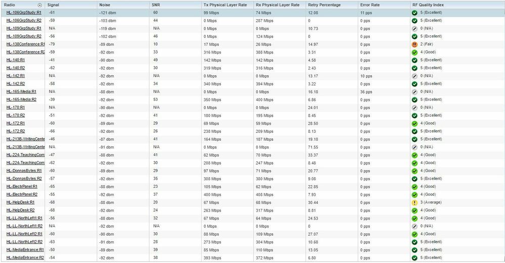

While digging into this, I stumbled on some extremely high retry percentages (see two examples below):

In both cases, you have extremely high SNR and RSSI, and a very low noise floor. Fantastic. These three things alone would normally dictate a very healthy environment that should allow for maximum data rates to be used.

In your examples, the Error rates are zero. This indicates to me that there are no issues with corrupted CRC values. If there were, the frames would be discarded and would be considered an error.
The SNR, RSSI, and noise levels seen on the AP are so good that you're not dealing with a 'distance' related issue (are there APs located in the same room as the devices??) At these levels, the devices shouldn't have any issues with even the highest BASIC rates being set.
What can't be accounted for here is CCC (co-channel contention) related problems - basically meaning high channel utilization - airtime is too busy to allow devices to communicate in a timely manner.

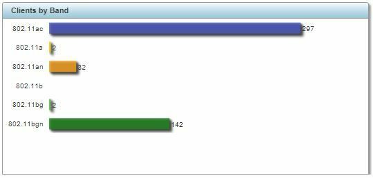

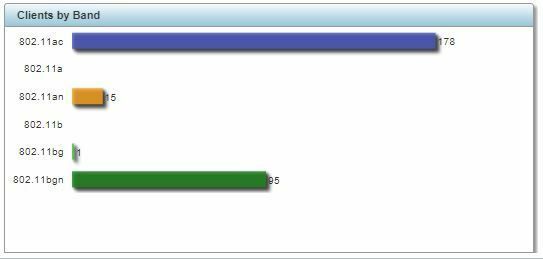

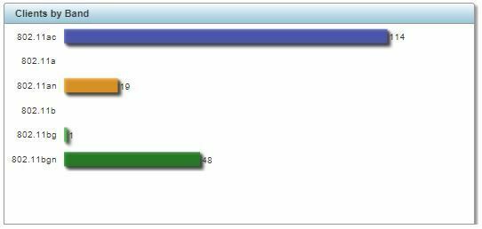

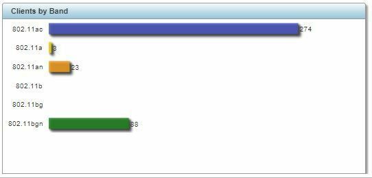

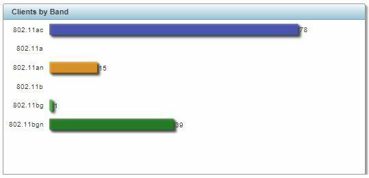

My overall goal with SBC would to help steer devices toward the 5GHz spectrum and lessen the load/utilization of the 2.4GHz spectrum:
Below are some of my residence halls:
And some of my academic buildings:
These are stats from only 6 of our 20 RF Domains, but this shows ~75% of connected devices are on 5GHz and the other ~25% are on 2.4GHz. Perhaps that is fairly well distributed on it's own and I don't need to worry about band steering?
Lastly, yes, I see see some Poor and Fair quality RF Quality Indexes, but the overwhelming majority are Excellent and Good (and N/A?).
Max

What I'd want to look at next is the client distributions. What radios (bands) are clients using?
Go to Statistics->(Select an RFDomain in the tree where complaints are coming from)->Inventory
Also found at:
Dashboard->(Select RFDomain)->Inventory Tab
Look at the widget for "Clients by Band".
11ac means only 5GHz
11a means only 5GHz
11an means only 5GHz
The last three mean only 2.4GHz
You want to see as many possible users using the 5GHz band primarily because 2.4GHz channels are most likely to have extremely high contention levels, interference (both ACI and non-802.11-based). Unfortunately nowdays, 2.4GHz needs to be treated as a best-effort band for wireless devices. Some users will even go to the lengths of creating two identical copies of their WLAN Profile (one applied to 2.4 and the other applied to 5GHz radios) with the only difference being that one of them has the SSID 'WLAN1-SLOW' and 'WLAN1-FAST'. Users see both and guess which one they want to use?  But this makes it so that if there ARE any 2.4GHz-only devices out there, they can still connect.
You can also see a different representation of this same info in the widget "Clients by Channel". This one though breaks it down by actual channel number, which isn't as important.
Also, in addition to the Inventory section, look in the Radio->RF Statistics section and select one of the RF-Domains in the tree where you see complaints. Look at the last column for RF Quality Index? See any listed as Poor or Fair Quality?
