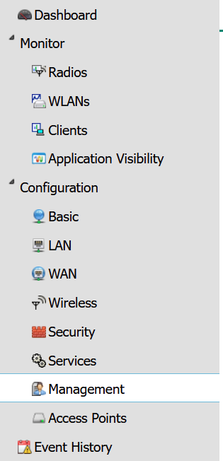

‎01-20-2022 11:58 AM
Hello Matt,
This feature is not supported in WiNG Express which is what your APs are running on. My recommendation is to upgrade them all into WiNG Enterprise and configure them from there per Angelos instructions.
Here's a link with instructions on changing your Express APs into Enterprise: https://extremeportal.force.com/ExtrArticleDetail?an=000089916
I hope this helps,
Chris

‎01-20-2022 09:31 AM
Hi Angelo,
Thank you for clarifying. Under configuration I do not have these options. See below for how my menu looks. I went through every one and do not see the options you are mentioning.
