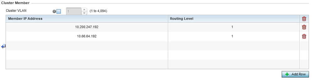

Can you run this query:
# show mint stats
# show mint info
Your setup in the GUI should look like this...except I don’t know what your MINT routing level needs to be. I’m hoping to determine this from the output of the above queries.
