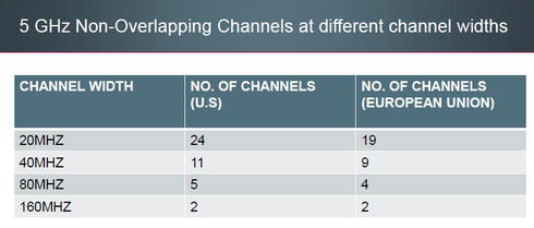

Here another slide that illustrate how channel width affects the available non-overlapping channels...
8de28d961bd34c0fa465a439300ad05e_RackMultipart20150217-6670-a5xo97-5GHz_channel_width_inline.png
