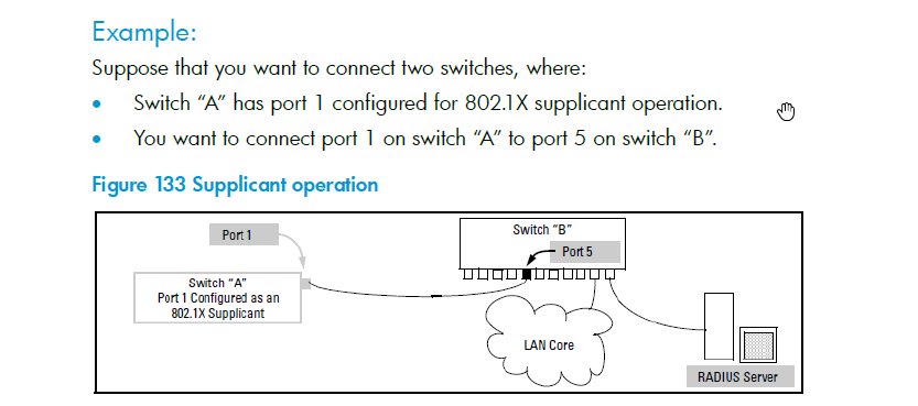

Gents,
let’s look forward into the future, not back into the past. HP does it because they have nothing else to do, they missed entire fabric play and BTW now are trying to chase it.
Choosing between implementing 802.1x supplicant and Auto-Sensing feature I'd better have latter.
In the picture from HP manual - what is real world use case? Switch A in uncontrolled environment, where anyone can plug/unplug uplink, and concern is that malicious user can gain access to uplink traffic ? But 802.1x doesn’t solve it. Perhaps HP/Aruba lied to customer about it, but in reality I just need little hub between SwA and SwB - and here you go, I have access to all traffic !
What we can do on EXOS to have similar level of protection - LLDP. configure custom LLDP data, and use UPM port to block port unless you see proper string in LLDP.
But it’s a kludge of course, you should use MACSEC if customer is really concerned about security.

Hello,
since this feature is missing we have just failed to replace 140 HP switches with XOS switches. HP (now Aruba) has supported this feature for years.
Specifically, this is a project where Fiber to the Desk is in use and therefore there is a switch in every office. To prevent an employee from being on the network after unplugging the switch, authentication must also be performed on the uplink, not just on the access.
Here a screenshot from the HP manual
And NO VSP is no option here in the moment for the customer.
