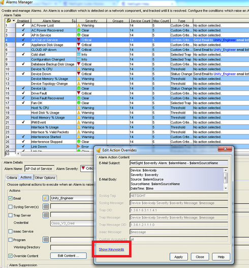

NetSight Alerts for APs, deliver AP name instead of SN...
I have Netsight configured to alert me if a AP goes offline. This is a typical email:
Device:
Severity: Critical
Message: AP[13140661595A0000] out of Service on EWC[10.22.110.32]
Netsight relays the info the HWC delivers to it via syslog (i think) The AP is identified by SN. SN is useless to me unless I x-reference though the controller. Can the alert be changed to identify AP by name instead of SN?

‎12-10-2014 04:53 PM
In Alarm Manager > Actions > Overwrite Content > Edit Content > Show Keyword...
That will open the browser with the Online Help with all the varaibles.

‎12-10-2014 01:53 PM
Is there a reference where to find all possible variables?
‎12-04-2014 06:16 PM
Thanks Doug. $AlarmSourceName was exactly what I was looking for.
