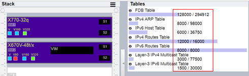

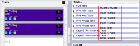

‎06-16-2017 02:12 AM
Hi Andrew,
I really understand about that table but I still don't get it in relation to my question. My main question is about to see if separating two X770 and two X670V/X670-G2 into two stacks is better or worst idea than connecting them all into single stack since all of them support SummitStack-320 and SummitStack-160.
Best regards,
Best regards,
Hi!
It's depends from your goals.
If you need more ports - then it can be single stack.
If you need more performance - you need separate stacks (In case - stack X770 with X670V).
If stack X770 with X670-G2 - you can use single stack.
If stack X770 with X670-V - you can see stack performance degradation
You can check this in https://stackingtool.extremenetworks.com/StackingTool/
Thank you!
Thank you!
