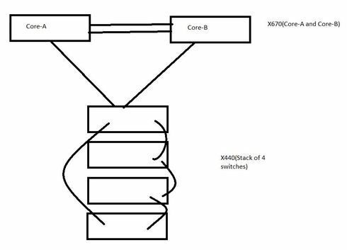

We have Core switches(X-670) that connected to X440(48 ports) stacks of 4 switches. Is this supported "48 ports * 4 switches =192 ports" connected to single MLAG id?

connecting a stack to a single MLAG id is not a problem.
You may see problems with the capacity and you can solve that through increase the bandwidth of the total LAG by adding "normal" LAGs between the Core switches and the stack.
See the example in the documantation:
https://documentation.extremenetworks.com/exos_22.1/EXOS_21_1/Slots_and_Ports/c_scalability-impact-l...
