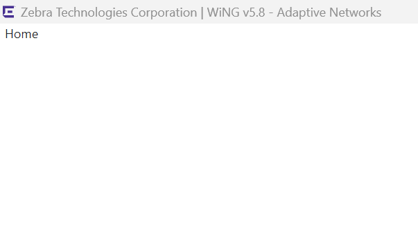

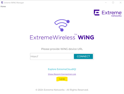

Hi
Removed V1.0.9 from PC
Installed Version 1.0.10 - Install successful
No connection is being establish when I Input Wing Device URL and click connect.
I am only presented with a Blank window with the only option available is home See below.
Please advise (Is new V 1.0.10 up and running)?

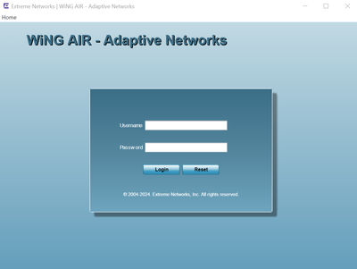

Hello @CL,
I just tested this and everything seems to be working as intended at least in WiNG 7.x:
I believe the issue you are facing is with WiNG 5.x devices, is this correct?

CL
Yes that is correct - Wing devices are all 5.8.x or 5.9.x
Ap650s and AP7522s
