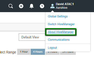

dsouri
Contributor III
Hello,
To verify transport/firewall are not the issue, as Jeremy suggested, use the About Hivemanager Menu to access the Firewall Guide.
Firewall_Guidelines
This guide will advise what transports will be used when Aerohive Devices need to communicate with Hivemanager.
If we can verify that transport is not the issue, we'll want to be sure all HiveOS Versions on APs are the latest Golden/recommended or Featured release.
Additionally, in the Network Policy -> Additional Settings -> Device Data Collection -> please confirm that Application Visibility and Control as well as Statistics Collection are enabled. If they are not, enable them and push a Delta update to all Network policy devices.
I hope this was helpful, and if you need any further assistance I'm happy to help,
