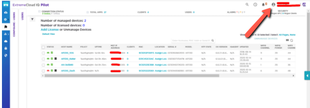

If I click on Global Settings, nothing happens!
I’ve tried every Browser I got but nothing happens.
Any idea?
10-14-2020 10:42 PM
You’ll need to add a license to your HiveManager instance before you can leave that page or update the APs. To get a new license you will want to reach out to your sales engineer or partner you purchased your devices from.
After you’ve applied the license, click on this silhouette icon in the top right corner to find Global Settings:

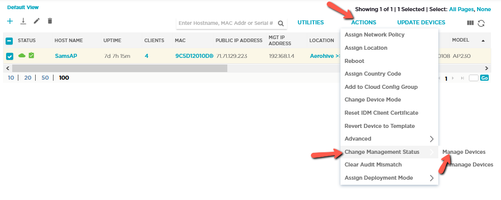

To change the management status back to managed (again after you’ve applied the new license so you see the correct options available), check the box next to the AP> Click Actions> Change Management Status> Manage Devices:

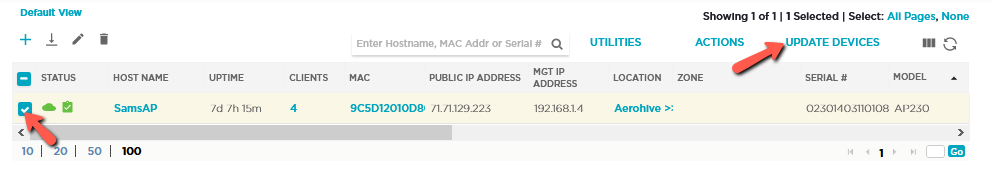

To update the APs firmware you’ll want to check the box next to the AP and click Update Device (which will appear on the screen you took a screen shot of, after you’ve applied a license):
