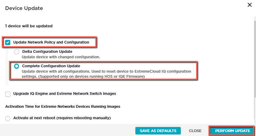

Hi Shelm, thank you for reaching out, we can certainly help you with this. Since you have already changed your password, we just need to update the AP so it has your latest settings. To do this, log in to your XIQ instance> Go to Manage (puzzle piece icon on the left hand side of the page> Devices> Check the box next to your AP or APs (you can update all your APs at once or a few at a time, it’s completely up to you)> Click Update Devices.
This will bring up a new window with Device Update at the top. Check the box next to Update Network Policy and Configuration, which will show you two update options. You will want to choose “Complete Configuration Update”. Note that this will reboot the AP, so there will be a brief network down time while the AP reboots. Click Perform Update. This will close the smaller window and bring you back to the page you see your AP on. You should see a green update status bar showing you where the update is in the process.
