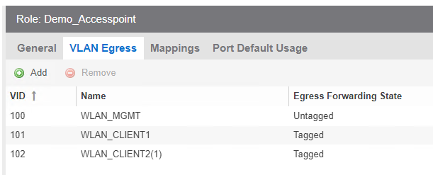

I’m trying to enable Extreme NAC for Cisco switches. It works fine for Clients on Access Ports. For Accesspoints (local breakout), I’m trying to get a trunk interface with management vlan untagged and data VLANs tagged.
For XOS Switches, I would create a Role with the needed VLAN Egress config

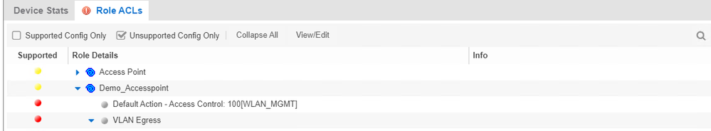

But I cant enforce this role configuration to Cisco switches
How can I achieve that for Cisco switches with Extreme NAC?

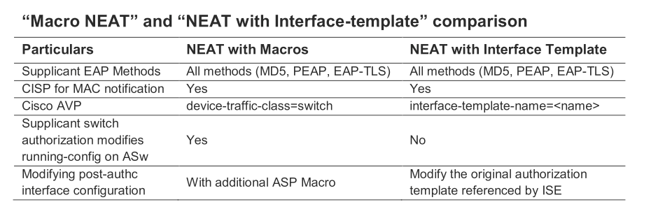

Yes sure, I can share my cisco config. In the meantime, I tested NEAT as well and it seems to be easier than using macro.

Comparison Smart Port vs. Macro:
