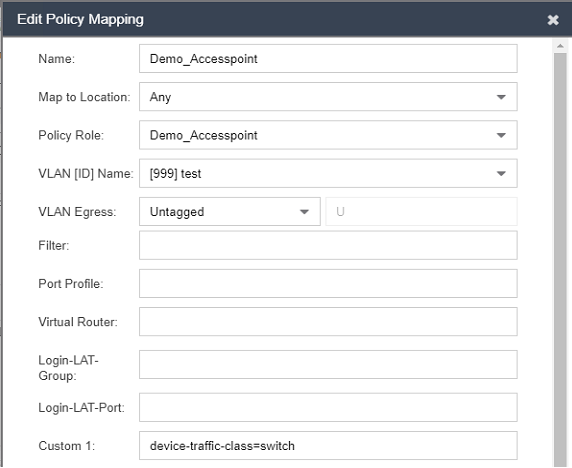

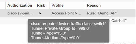

So my first step is to get it running to convert a port from access to trunk. Dynamic VLAN is my next stept.
Based on the documentation, I did following configuration.
Radius attribute configuration:
Policy mapping:
Set the custom 1

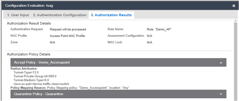

The result is that in the “End-Systems” tab it looks fine with the defined attributes (cisco-av-pair is set correctly)
the config evaluation tool looks fine as well
But on the switch the interface remains as access port. So I did a debug on the switch and a tcp dump on the NAC engine. In both of them, I can’t see this atrribute.

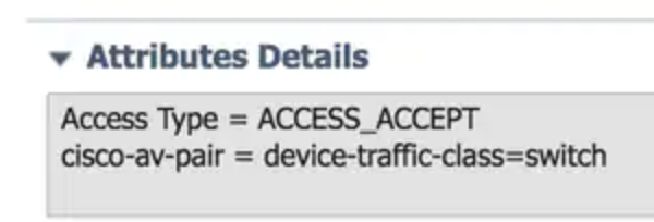

For me it looks like the NAC engine doesn’t sent the attribute but the attribute is shown in the dashboard.
regards
Michael

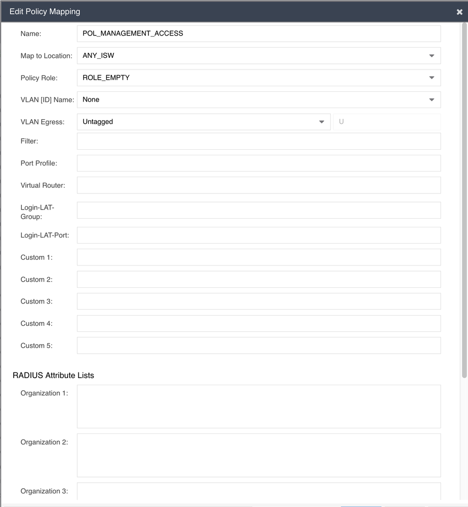

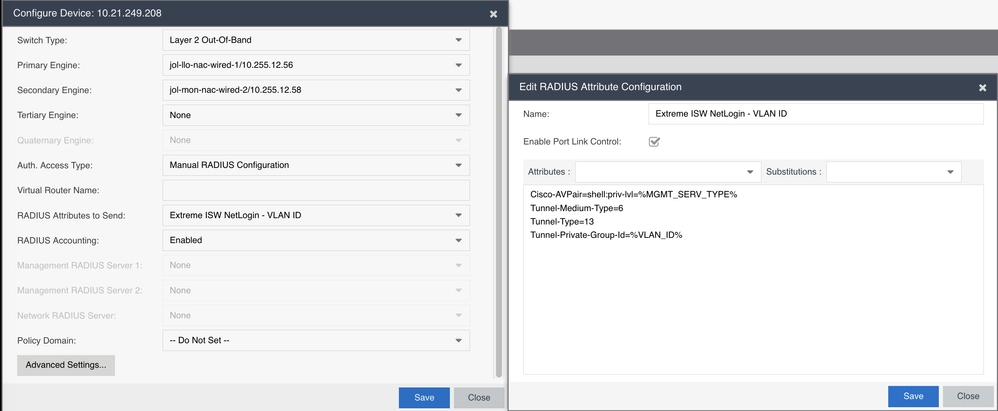

Michael,
For Cisco switches to understand the dynamic VLAN provisioning there is some more things to do.
Have a look here:
As you’ll see this part is specific to Cisco equipment.
On the Extreme side you’ll have to send this (aligned with your config):

I understand that I have do do it via Radius attribute. But I don’t understand where I can define the native (untagged) and the list of allowed vlans.
Miguel-Angel_RO
Valued Contributor II
Michael,
For cisco switches you cannot enforce a Role from the policy domain.
You must send standard and Cisco radius attributes only.
The standards are those in the Policy Mapping and the cisco specific are to be defined via the Custom/Organization fields in Policy Mapping and/or via the “configure device/Radius attributes to send” from the switch in the NAC group Engine:
Mig
