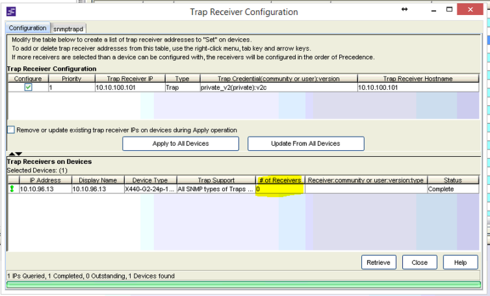

1 - I enabled the trap on switch ...
#enable snmp traps port-up-down ports all
2 - Created port group...
3 - checking the Trap Reciever ...
All devices --> right click on the device --> Trap Receiver Configuration
Note: # of Receiver is 0

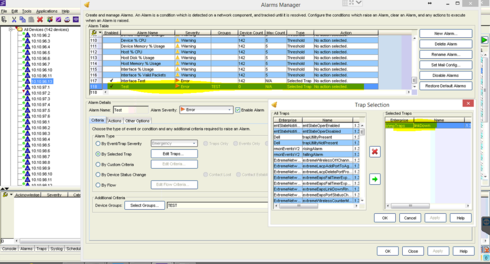

4 - created alarm
Any more steps to be done!?
