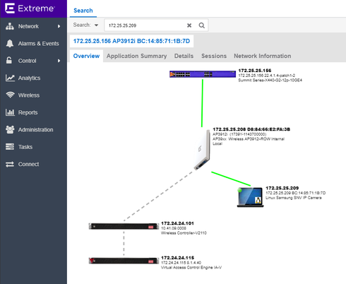

I'm looking at that screenshot closer, it shows what switch the AP is plugged into but it still doesn't show what port its in. Unless its on a different tab or screen.

‎09-25-2018 08:23 PM
e.g. I've enabled MAC based auth on the switch port with a allow all rule = in that case it's just to feed the information to the NAC.
That allows me to see the whole link (device-AP-switch) if I do a search for a device...
Sorry, but how do you authenticate an AP to the NAC? This would be great if in Netsight would show where an AP is physically plugged into from the end systems tab, rather than having to look it up by mac address in compass.
