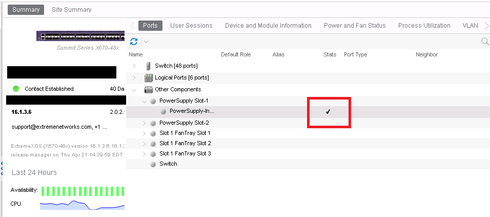

2) not all "interfaces" are shown in this flexview
For example - you'd also enable it on "other components" like the PSU (screenshot below) - I have no idea what that will do.
I think that is the main point... I don't unterstand what I get out of it = should I have it enabled for everything and also for the "other components".
